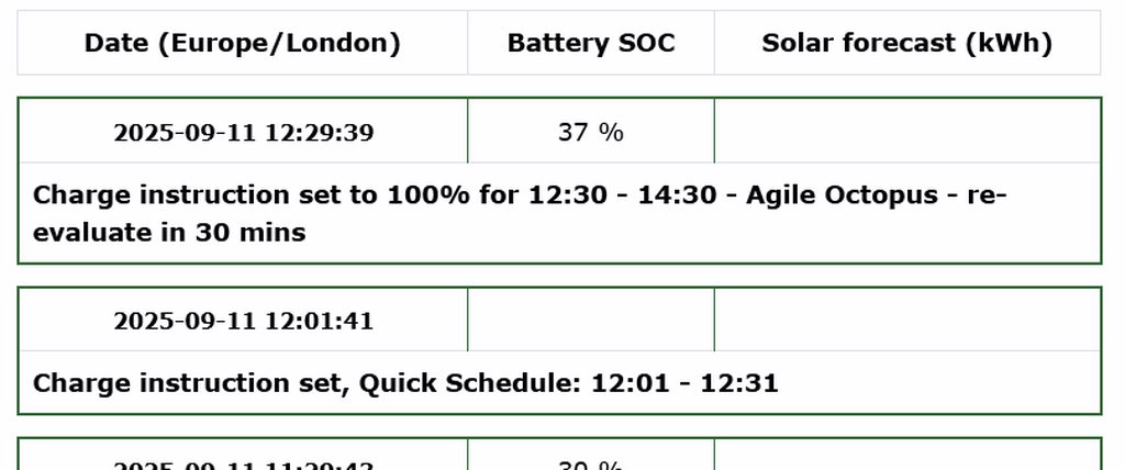

I did a WW quick charge at 12:00 for 30 mins.
WW sent the commands and said that end time would be 12:31.
There was an Agile charge block scheduled for 12:30.

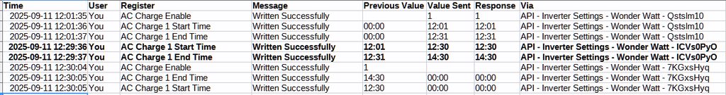

At 12:29 WW did the scheduled charge commands (12:30 to 14:30).
Then at 12:30, WW sent cammands to end the quick charge which cancelled the scheduled charge
Should the scheduled charge override the end of the quick charge?
WW log
GE log
