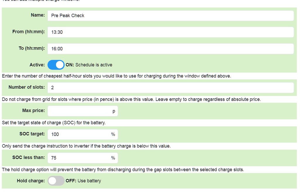

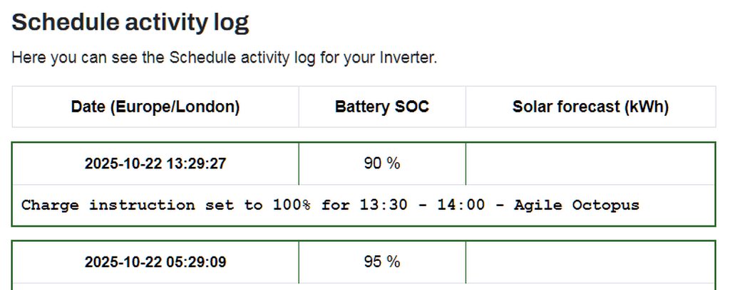

I did wonder if there was some data carry over when I switched the windows.
I have 2 similar windows from 13:30 to 16:00 one has SOC test 75% and 2 slots required.
The other has SOC test 101% 0 slots required.
Usually, the 75% window is active to make sure there is enough battery to get through the peak slots into the evening. If Agile prices are low, I flip to the 101% window and manually select slots to do charge/export sequencing, or to stop a full battery discharging and force solar to export/use the grid.
Then next morning, if Agile prices are back up, I flip back to 75% window,
