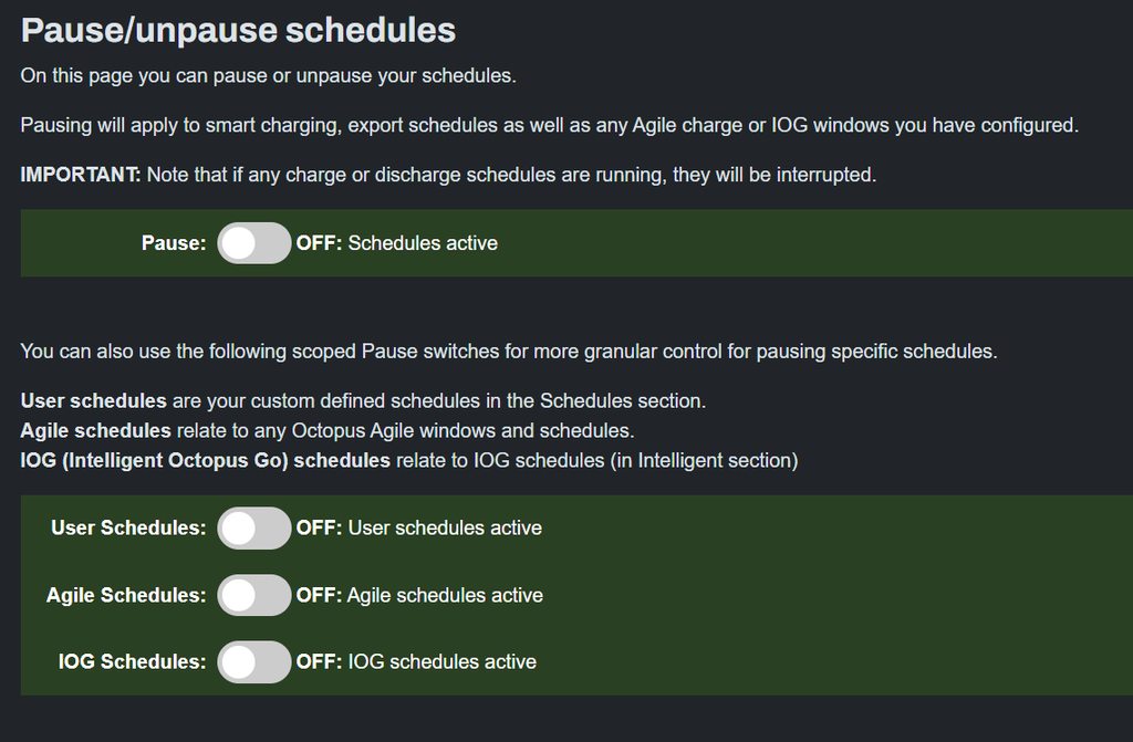

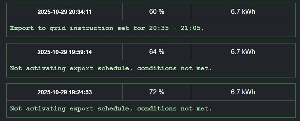

MrMessy RacingSnake you should get a message in the Activity log, whether the schedule has activated, or not, like this... Are you sure schedules haven't been paused here? https://app.wonderwatt.com/pause Should look like this, if everything is active:
RacingSnake Thank you Mr Messy for your reply. I've checked and the Pause is not active and there is definitely no entries in the activity log for yesterday. (I would love to add a screenshot, but all I get is a HTTP reference inserted).
admin RacingSnake Looks like you had an IOG schedule due to start. From our own diagnostics log, we can see: User weepy-dish has/will have active Intelligent Octopus schedule in next few mins - skipping export schedule
