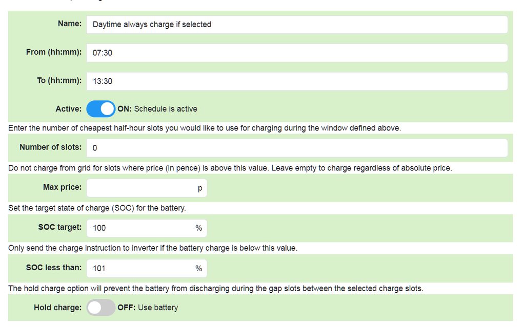

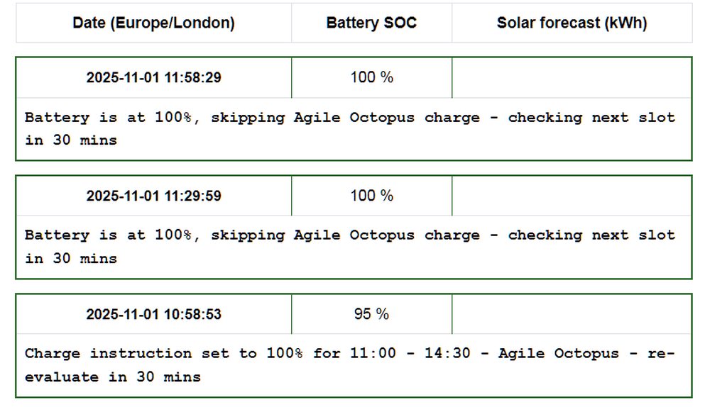

johalareewi I have Agile window that is active with SOC test = 101% I have manually selected charge slots but WW is skipping them because battery SOC is 100%. neighboring-volume
admin johalareewi Looks like this is because the continuous block ends at 14:30 - which is outside of the Agile charge window. We will get this Advanced setting out soon, that will be much easier and neater.
johalareewi admin We will get this Advanced setting out soon, that will be much easier and neater. I think it will be.
