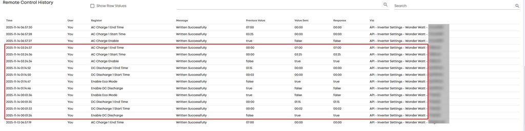

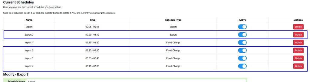

Not sure what is happening but have started to encounter a few issues recently.

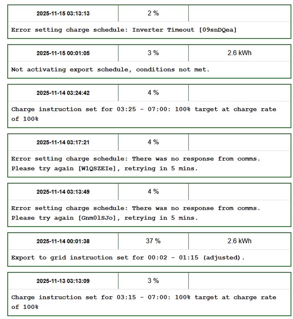

The most recent issue occurred 14th to 15th when certain instruction sets didn't get sent to the inverter which resulted in the battery charge settings not being sent and no battery available for today.
For some unknown reason all the instructions in the red box from 00:01 to 03:24 were not sent by WW to the inverter on the 15th
