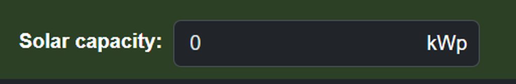

In your WW >> Settings page, you must put a minimum of 1 in the kWp value.
is not allowed and will produce an error. Enter 1 in this dialog box.

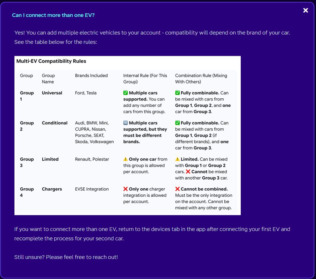

But it makes no difference to the operation of WW, which should, if connected to your IOG setup, on the Octopus >> Intelligent page, will then set to charge your home battery when you get a slot by Octopus for your car. You can however only have 1 car on IOG at a given address, so you will need to work that through by charging the hybrid manually between 23:30 - 05:30 [easy] or putting it on charge when you get allocated a slot during the day [very difficult, as they move around].
