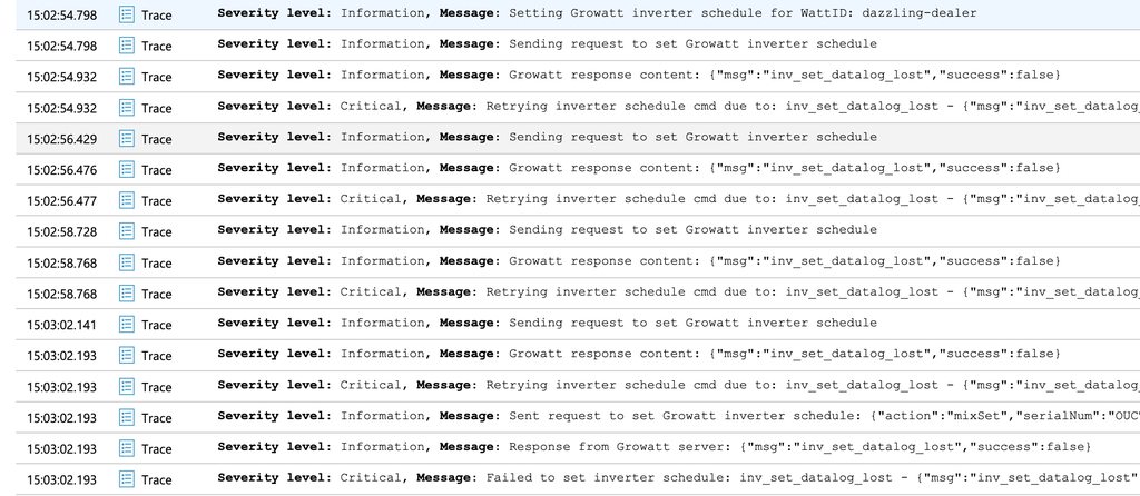

PANface Hi Last couple of days i have been having: "Failed to set inverter schedule" nothing has changed at my end and i have checked wifi etc and all seems okay. can you check and advise please 2 x inverters dazzling-dealer and snoopy-island Thank you
admin PANface Clearly looks like the datalogger could not be reached looking at the Growatt API response from our detailed log. So definitely a comms issue of sorts.
PANface does this mean its between my data logger and mesh in my home? or could it be external? Help is required at this point
PANface Update: Im not sure if i sorted it or it sorted itself, but what i did was reset my car wifi connection and also my shinephone dongles, touch wood it seems all to be working as perfect as before 🙂
