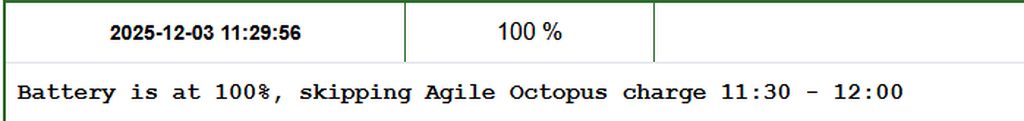

palaceben There is an enhancement in the pipeline to have an advanced setting where you can have the "skip charge when battery SOC = 100%" on or off as you require (currently it is fixed to on all the time).

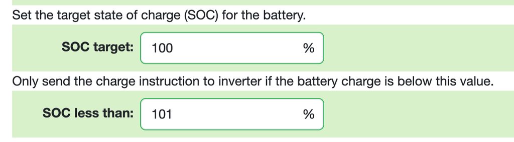

For Agile slots in an Agile charge window, you can set the test SOC% to 101 which will then always charge because the battery SOC will always be less then 101%.
This workround doesn't work for Agile slots outside of a charge window though. 🙁
