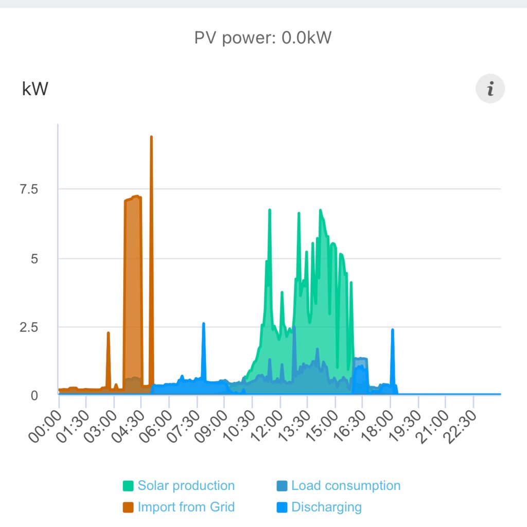

To share on some observations on charging behaviour of Growatt XH
9/10 times I see the following pattern ;
So the charging session reaches the target (30% today) early - it seems to me that Growatt is in practice charging at much higher kW than expected by set rate (in above graph, WW had set it to 44%) while seen from import kW it seems to be charging at about 75-80%.
But than something funny happens; towards the end of the session (5.00u) , battery has (apparently) dropped below target again because of consumption and it gets another charging boost , but this time full power or 100%.
Now, I do not mind so much, but I curious to why this may happen ? Do you reset the charge rate as soon as target is achieved ?(which would explain this) . Or only at end of session ?
Thinking about it, this may affect people who have set a lower charging battery rate - this later “top up” would seem to ignore any limit set.
