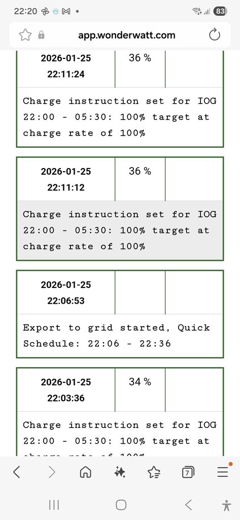

Similar issue has occurred this evening. I plugged the car in earlier, and Octopus allocated several continuous slots from 22:00 to 05:30. I unplugged the car as I'd decided to let my discharge schedules run, then plug the car back in to charge during the 23:30 - 05:30 period. The Octopus slots disappeared from the Octopus App. However at 22:00 my home battery started charging from grid (see screenshot). I tried setting a WW quick schedule discharge hoping to override it but it had no effect. I rebooted the Inverter via the GE portal which eventually stopped it for a while but then it started charging from grid again! I've now plugged the car in again and its started charging (Octopus slots have appeared again).
Update today (Mon) car charged okay overnight. I'm wondering if this issue is simply caused by plugging the EV in, receiving Octopus slots for maybe much later in the day but unplugging again before any charging occurs (which is probably not a 'normal' action). Even though Octopus have removed the charging slots, WW still has them registered and proceeds with charging at the allotted time(s)?
