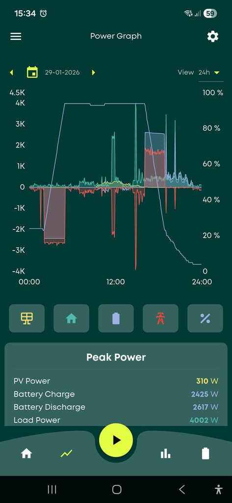

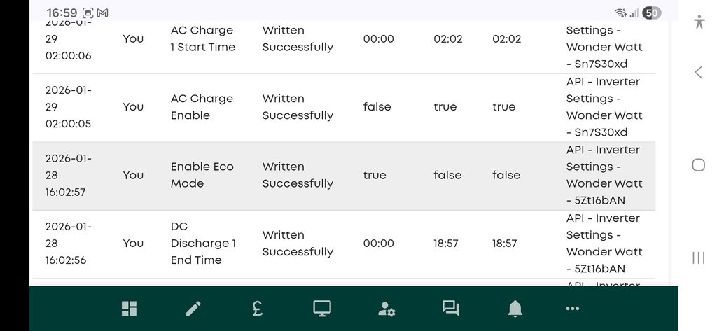

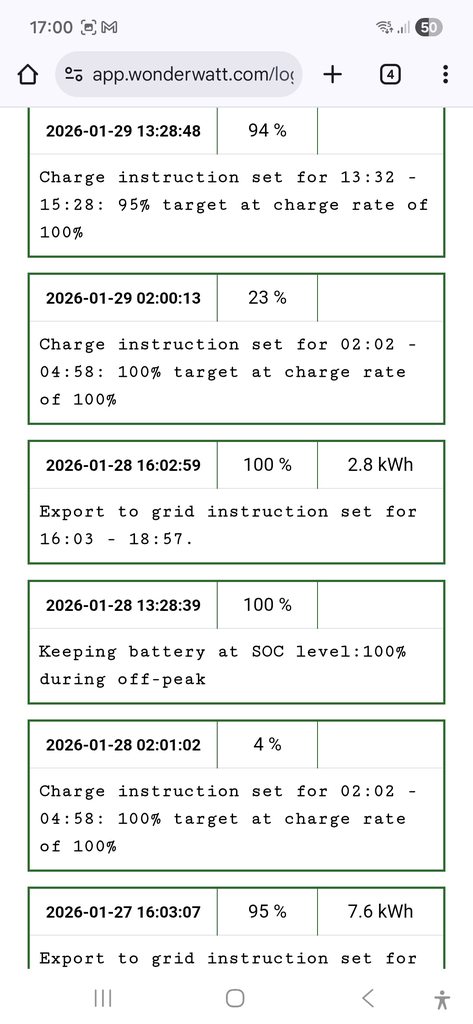

Hi WW, I noticed an error on my system on the 29/01/26. I've been using WW since 14/01/26 and it has worked reliably except on this day but worked normally again today. What happened was that on the 28/01/26 at 16:02 my Evening discharge started normally after disabling ECO mode but at 18:57 there were no log entries to stop the discharge from WW and turn ECO mode back on. The discharge window was set 16:03-18:57 and WW did not adjust the end time. I only noticed on the 29th when the battery SOC remained at 94% instead of supporting the house load.

Is this a random comms failure to the GE Server as it seems the stop export and enable ECO was not sent?
Log entries attached and App screenshot
