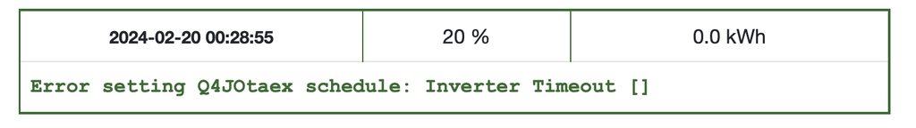

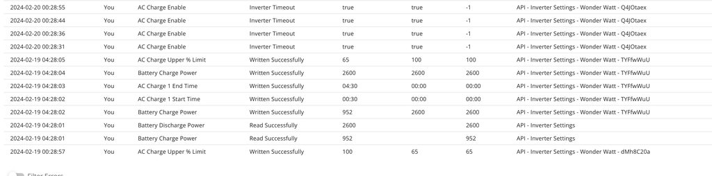

Avenir Hi @admin Should we be reporting Giv inverter timeouts on here? I had another one last night resulting in flat battery. Is there anything I can do to troubleshoot it?
admin It's worth reporting I'd say, yes. Especially as you can see the subsequent retries with a fair few seconds between them also failed.
