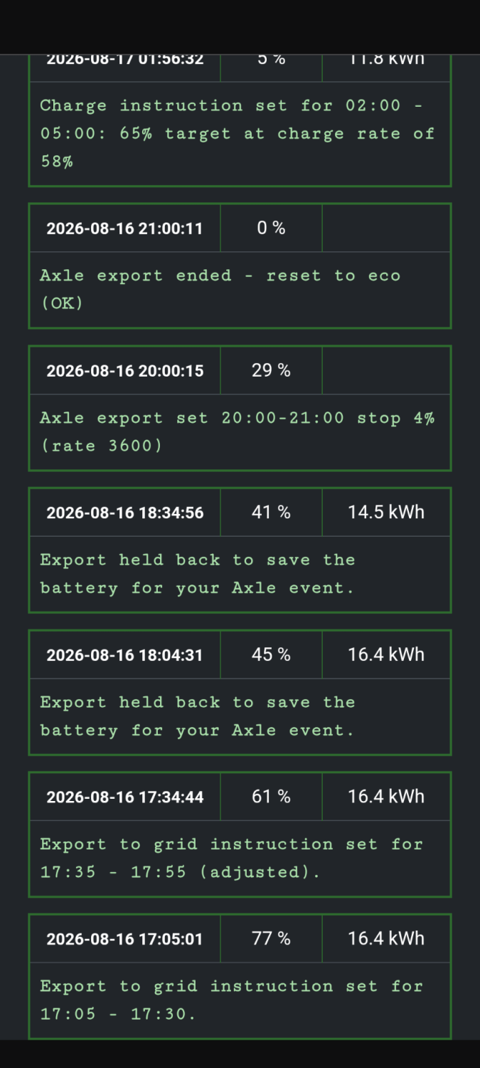

@admin: I did not do any manual disabling and the WW disabling of schedules in the 2hrs ahead of the Axle event works brilliantly and shows in the log (screen shot attached) - this solves the only comms duplication issue where Axle reads from discharging state ahead of the Axle event and then resets to the discharging state after the Axle event.

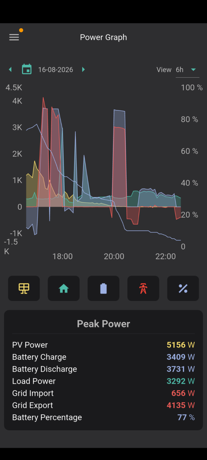

However, depending on the time of the Axle event I need a longer period than 2hours ahead of the Axle event. In this case my battery was exhausted at 8-30pm, half way through the Axle event (see GE power graph image attached) - a 3hr disabling period would have done the trick last night, but this very much depends on time of the Axle event - any thoughts?
