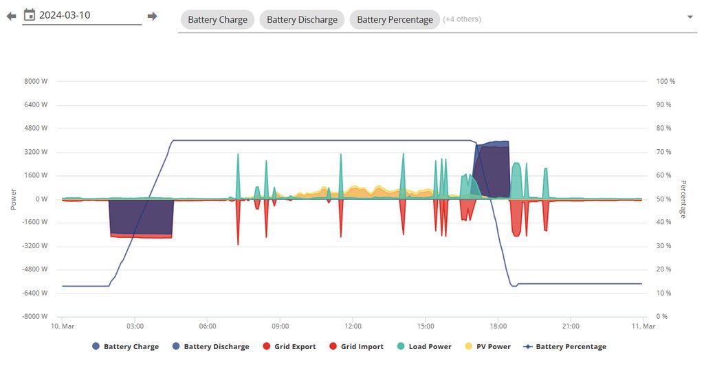

I have not changed any settings and since 2 days the WW commands to GivEnergy at the end of the charging and discharging window do not come through any more.
Nothing in the Giv log, no error messages.
This means system does not go in ECO anymore and I'm pulling since 2 days everything from the grid between charging and discharging windows. See below for today.
Can this be investigated please? I will set manually to ECO after this mornings charging session.
