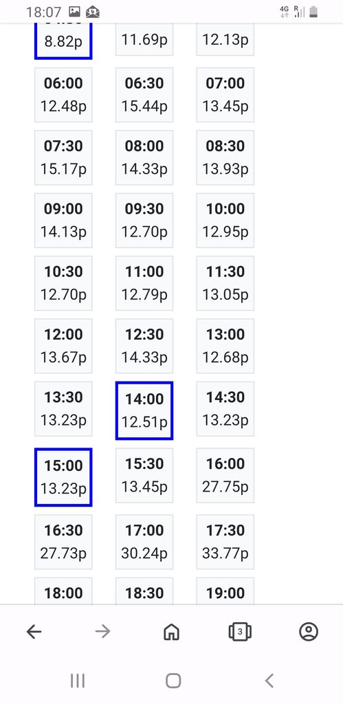

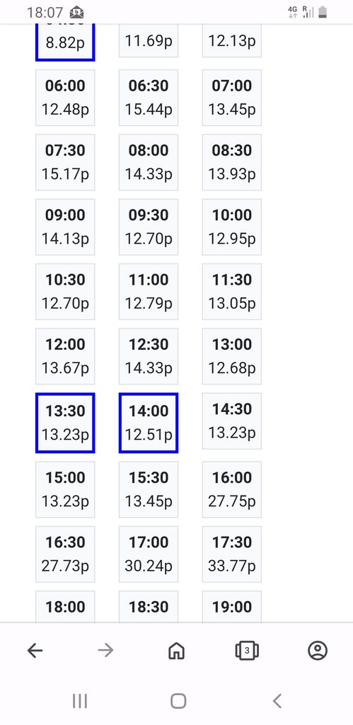

So in terms of the functionality: imagine if you have a 3 hour window 02:00-05:00 and want 2 agile slots selected (as part of your 'cheapest number of slots') and let's assume all prices for the full 3 hour window are equal.
Normally, you would end up with the two 30 min slots for 02:00-03:00 being selected.
The new behaviour is that the latest slots for which the price is the same are selected instead, so now this would be: 04:00-05:00.
Hope that makes sense.
