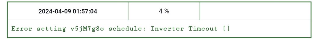

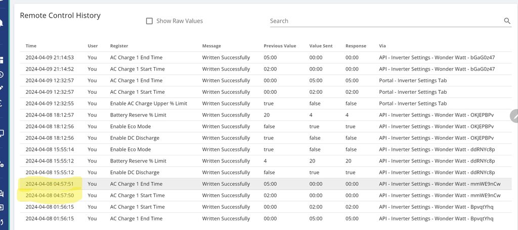

Thanks for the reply. For the schedule timer, I understand, no probs. As my charge requirement is for only 1 schedule, I shouldn't really need to use wonderwatt scheduler. But I have had occasion where the GivEnergy scheduler did not activate when it should have done which is why I set up in wonderwatt. The export schedule is working great for me!

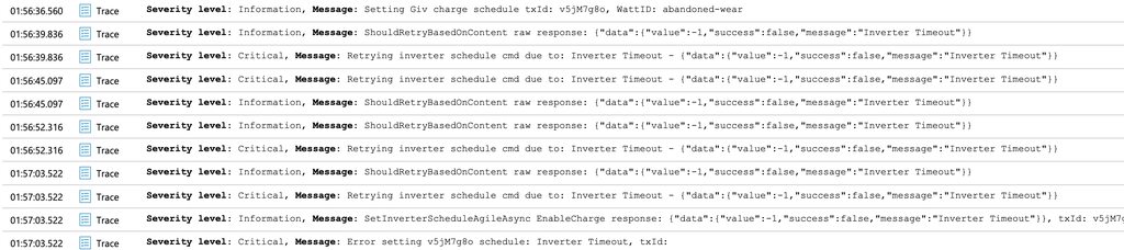

For the timeout issue, the reattempt calls are all sent quite close together. If there was a option to retry after say 5 minute interval several times that might have had success. I dont know how long my internet may have been down but suspect that was issue. This is 1st timeout I had, and most likely be my Internet provider (virginmedia) had issue during that period. My router was not set to reboot or anything, so hard for me to tell, but expect virginmedia was cause.
