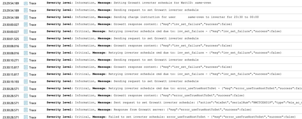

Jaspar Hi - probably a newbie error but set up Agile. 1st charge session worked then next two reported as "Failed to set inverter for Agile slot" Am a little confused as to whether I have the wrong settings WW ID: same-oven
admin Jaspar We got an error message back from Growatt, see the logs. One thing to make sure is to not have overlapping schedules anywhere set up on the Growatt side.
Jaspar Thanks for the prompt reply. Does that mean I should clear any sessions on the inverter / shine app & run everything through WW? Apologies if this is a daft question!
admin Jaspar Not a daft question at all. Yeah, it's better to make sure any existing schedules you have set up in Growatt either under Battery First or Grid First are disabled.
