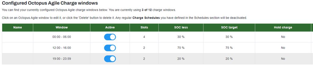

Agile Octopus Import Threshold: 0:00p
I have the following charge windows configured:

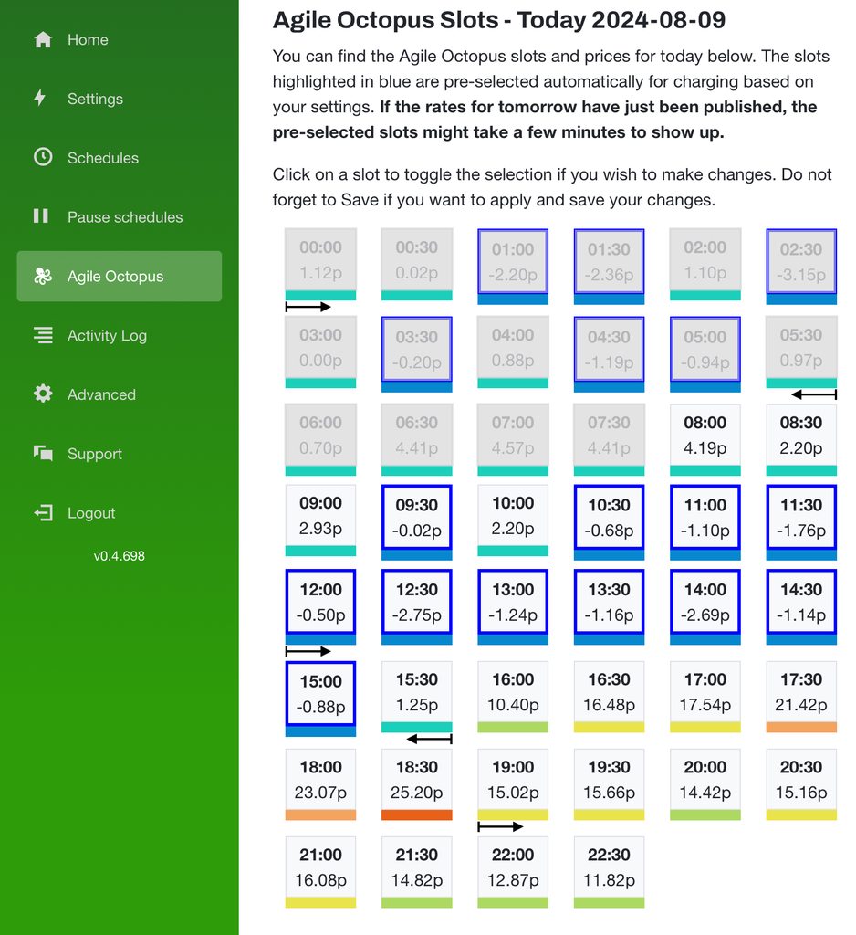

On Friday morning multiple Agile slots were below the 0 pence threshold:

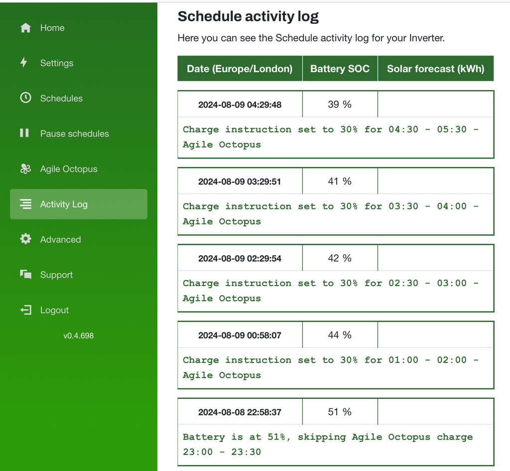

My wish would be that the battery would be charged to 100% overnight, making the most of the free electricity on offer. However the charge instruction was instead only set to 30% (my charge window target):

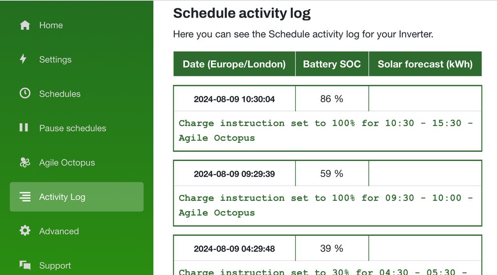

Later that morning when threshold conditions were again met, the charge instruction was this time set correctly at 100%, presumably because the start time falls outside of my configured charge windows:

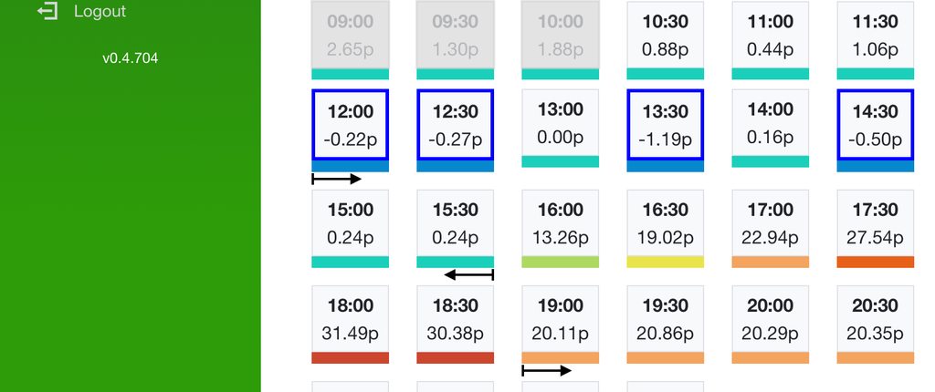

The following day slots were again below the 0 pence threshold, this time around lunchtime:

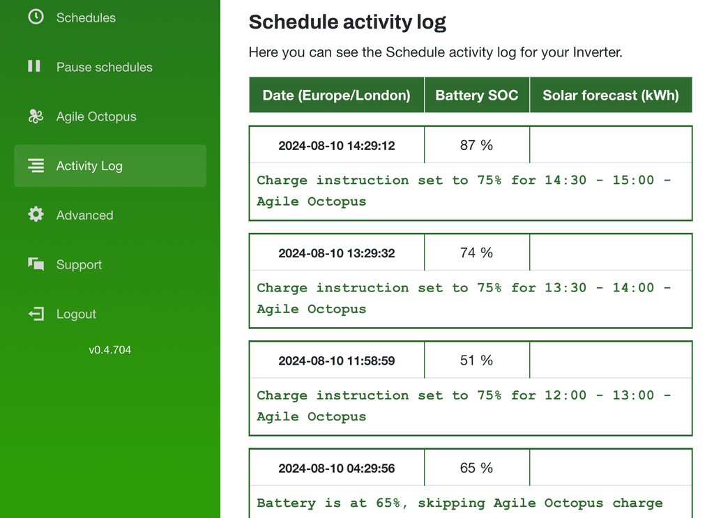

This time however because the slot time coincided with my configured charge windows, the instruction was again set to the charge window SOC target (75% in this instance):
