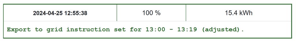

I need to try to prevent my batteries getting to 100% during the window 9am-3pm because if they do and it's really really sunny, my PV production will get capped because the excess production has nowhere to go if it can't fit in the batteries and I'm at max export rate. So I have set up 3 scheduled rules to try to prevent this. Unfortunately, they don't work. Here is an example of what happened today, taken from the WW action log:
The rule that triggered this says that if the battery is at 98% or above, force export between 1pm and 3pm down to 94%.
My batteries were at 100% at 1pm so triggered the rule. But despite the WW log, nothing happened on my system.

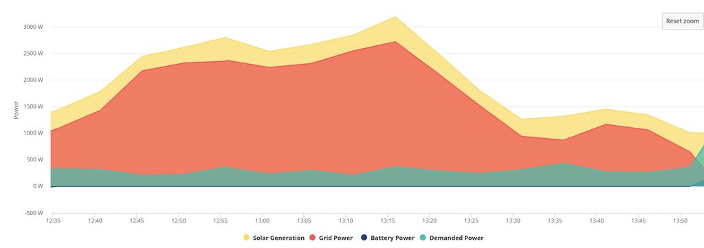

Here is an excerpt from the relevant time frame of the My Inverter log:
It was exporting yes, but not force exporting from the battery.
