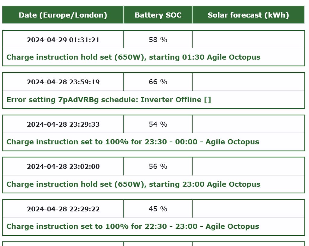

Last night I had 5 agile slots selected and a hold. WW did the first 2 slots OK. The next 3 slots were in a block but WW failed with inverter offline. As a result, none of these slots happened.
Would it be possible for WW to just drop the 1st slot in the block if there is an inverter offline situation rather than drop the whole block?
Here is what happened

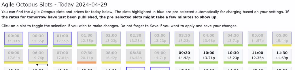

Selected slots
WW log

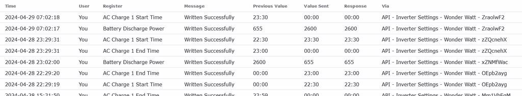

GE log
When the inverter offline happened at 00:00, instead of losing the whole block 00:00 to 01:30, it would be better if WW just dropped the 1st slot and tried again at the next slot.
