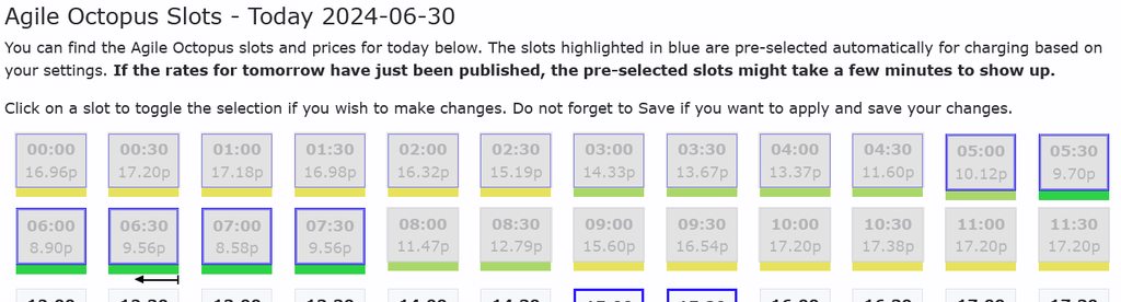

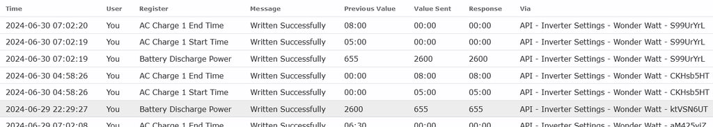

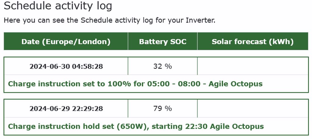

johalareewi 4 Agile slots auto selected last night (5am to 7am). These were the last 4 slots in the Agile charge window. I manually selected the next 2 slots after the charge window. WW sent commands to charge from 5am to 8am but at the end of the Agile charge window (7am), it stopped the charge so the manually seleceted slots never got actioned. WW log GE Log neighboring-volume

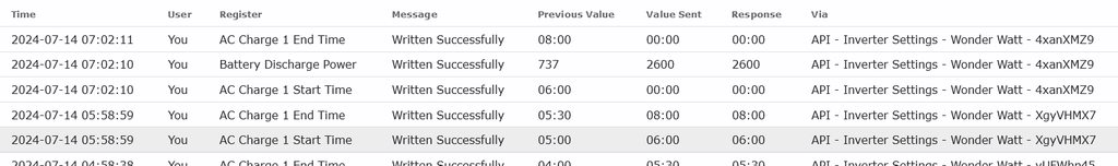

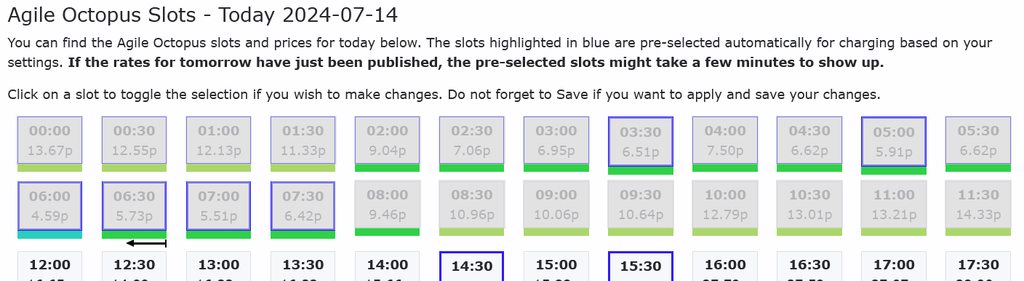

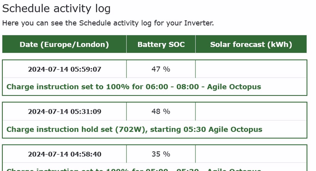

johalareewi Doesn't look this is fixed. Just did it again last night. 6am to 7am auto selected, 7am to 8am manually selected. WW set charge for 6am to 8am. At 7am (agile window end time), WW stopped the AC charge. WW Log GE Log neighboring-volume
