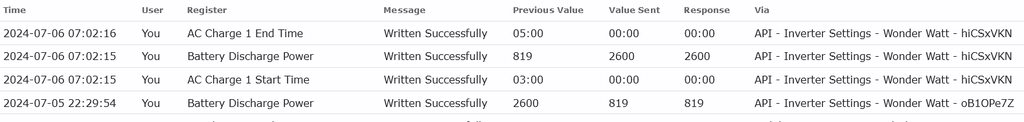

Still no Agile slots for tomorrow but WW has set the Agile Window HOLD at 22:30.
Will be interesting to see what happens at 7am tomorrow when the HOLD should be turned off...
Looks like WW executed the Agile charge window turning the hold on and off at the right times. It also reset the AC charge times that I had set manually.
