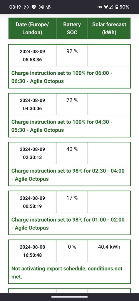

This remains an ongoing issue for me. I don't have connectivity problems via the ShinePhone app, nor the WW dashboard which shows the battery configuration, SOC etc. I have observed that:
- Agile charge slots overnight usually set correctly.

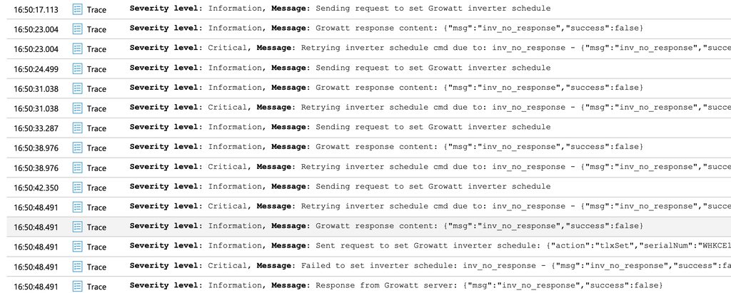

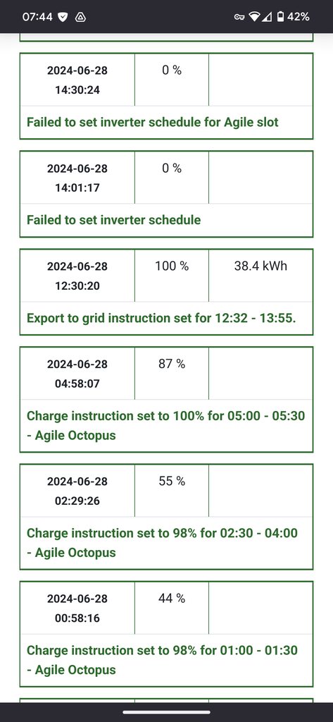

- Agile charge slots during the day fail, stating 'Failed to set inverter schedule for Agile slot'

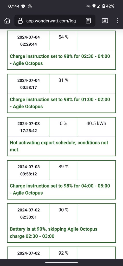

- Export schedules do NOT usually set correctly. It is often for these and day (but not night) Agile slots where the log shows that the battery SOC is 0%, but it isn't 0% in reality when checked via ShinePhone or via the WW dashboard (System Energy Flow): the WW dashboard correctly reports the SOC, but the export or day Agile schedule is still not activated.
If the WW dashboard and ShinePhone can both correctly read the SOC, why can't the export schedule / day Agile algorithm?
