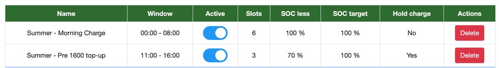

Thanks for your reply. In short, yes I only want to charge if the price is below my export tariff rate, since then its cheaper to grid charge and export more the next day. Otherwise I don't need a charge - my battery will still last all night.
If I leave the agile price set to 12p then WW sets all slots at any time for charging, with no regard for the cheapest slot. Can you add options to limit agile slots under a cap, prioritized by price?
Edit: Looking further ahead, it'd be great to be able to auto-set an export schedule to drain the battery if the upcoming agile price is below a different cost (e.g. 5p).
