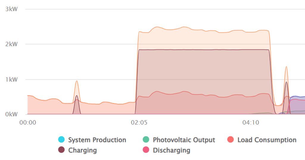

Hi, tried out WW for the first time last night. Must say it's much easier than the Growatt app, but overnight charge was not as expected.
I set a schedule to charge the battery between 2am and 5am, charge to 100%, with Auto charge rate on.
I expected WW to either charge to 100% and stop, or balance out the charge so I got to 100% by 5am.
However you'll see in the pic, it didn't go as expected. At 4:55am the max charge was 80%, so fell a bit short, maybe because of the weird drop off around 4:40am.
Have I done something wrong?
The alternative is I can set the auto rate off, but then it forces charging at 100% which i'd rather not do (I prefer around charge rate 85% so not to stress the battery). The Growatt app allows to set the charging rate, but oddly WW doesn't have this option.
One thing I did do was update the advanced settings to match my Growatt Hybrid SPH5000TL BL UP. Originally it set 3k for both battery rate (I updated to 4k), and inverter rate (I updated to 5k). Would this have thrown anything out?
