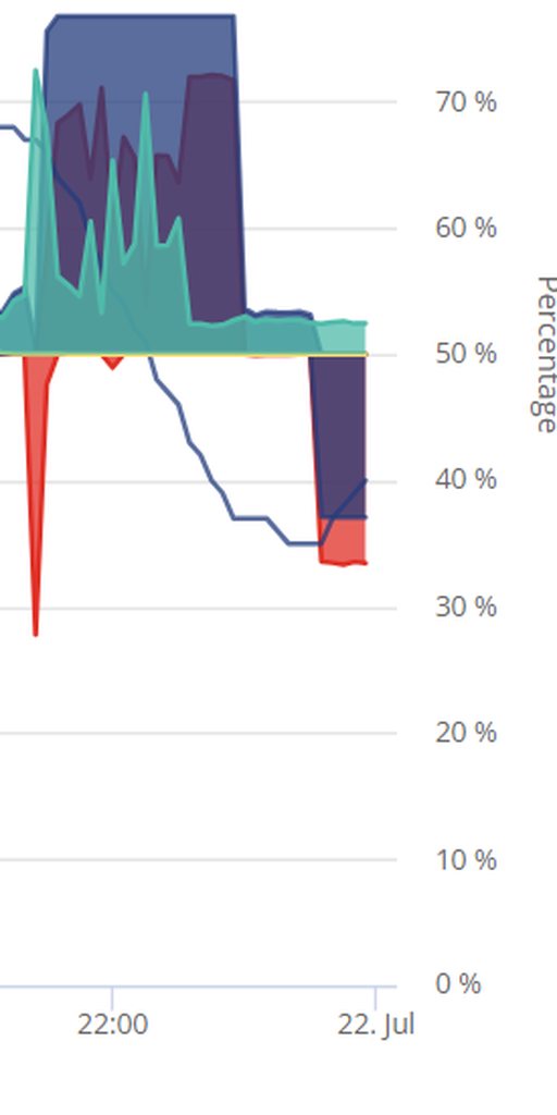

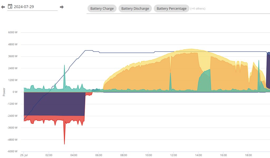

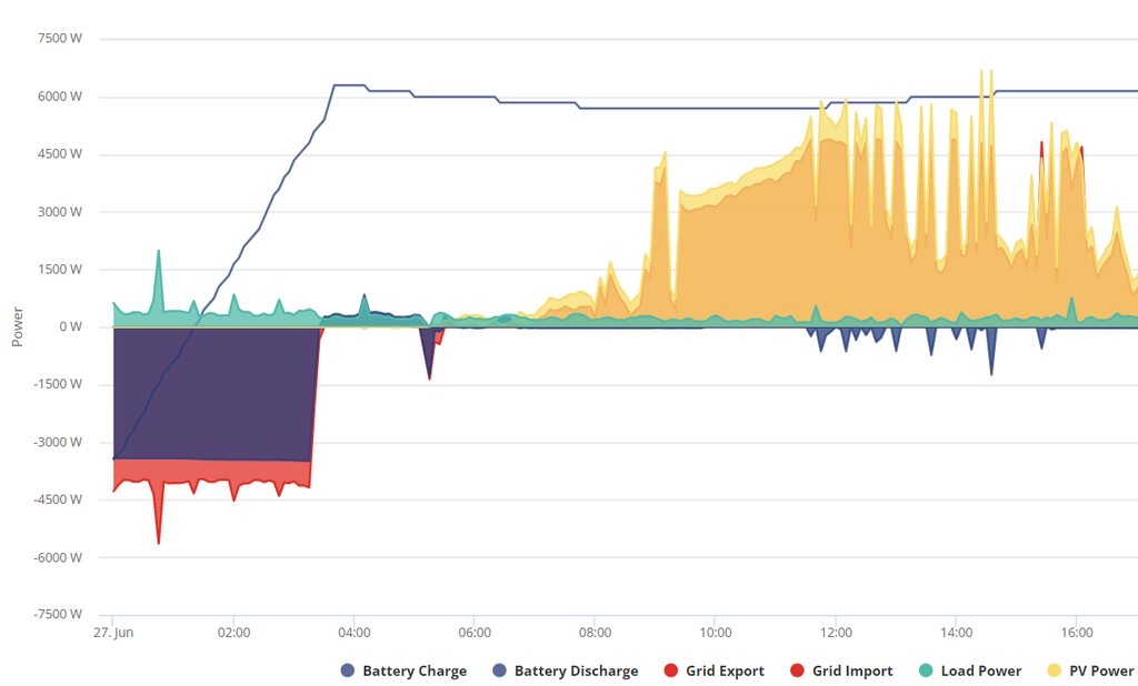

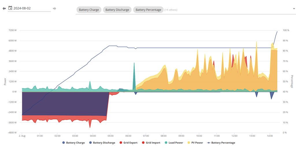

Today, for me, is a perfect example of capturing any clipping. It's a bit cooler than yesterday with some breeze too and broken cloud, unlike that graph from 29th which was hot, no breeze and wall to wall sunshine.
As you can see, the solar is peaking at around 6kW, whereas 29th didn't get above 4.5kW. The blue spikes below the line is the clipping being mopped up into the battery, which would have otherwise been lost.

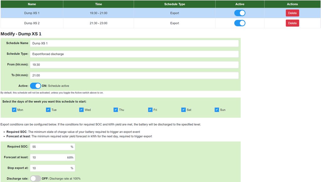

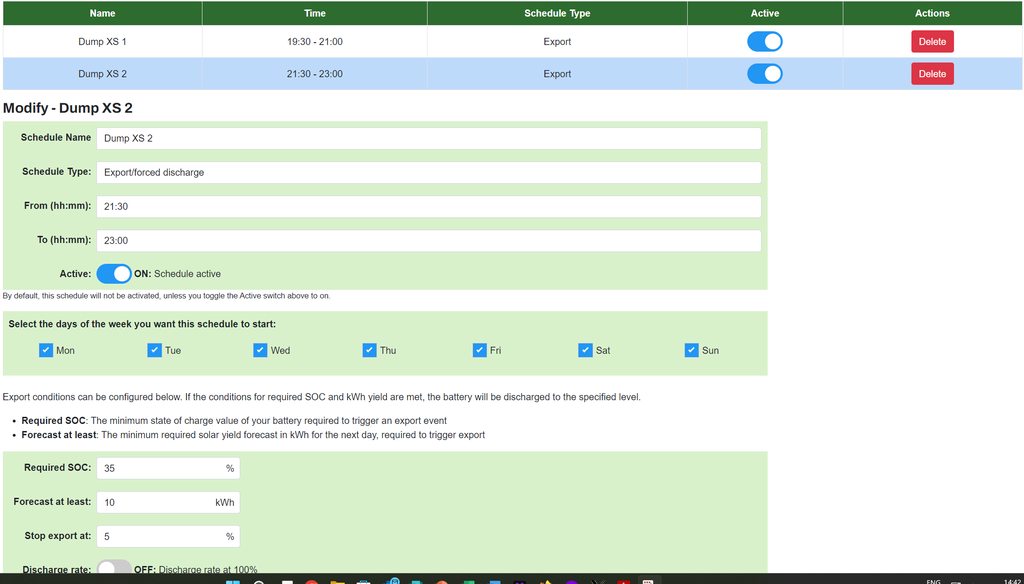

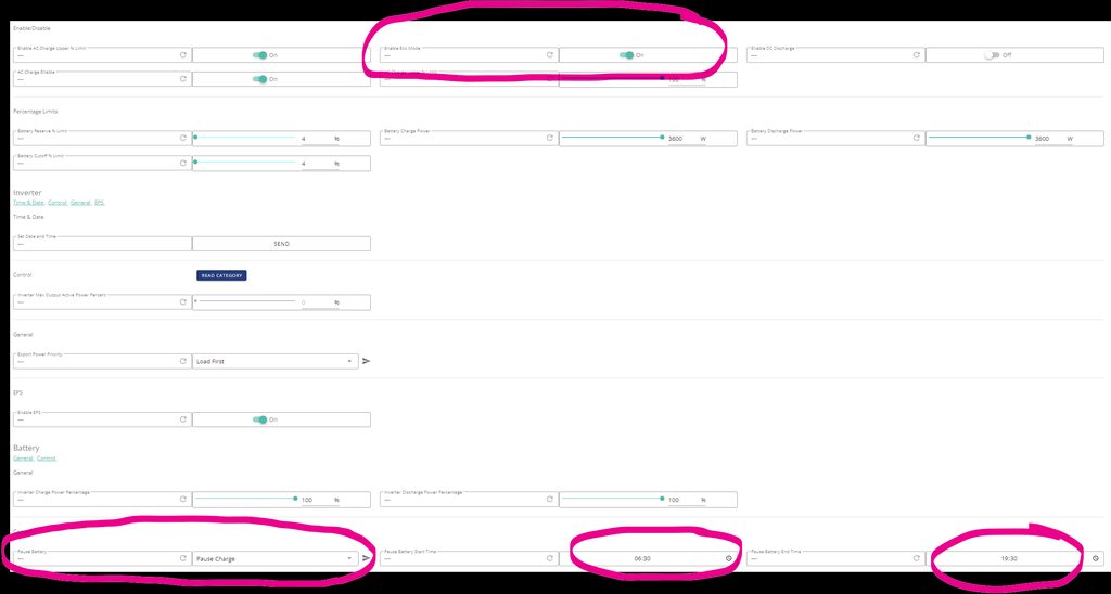

I've set in WW to smart charge the batteries to 85% overnight, this leaves approx 2.5kWh spare capacity.

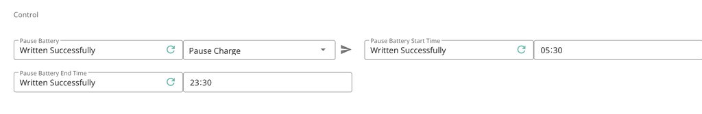

Pause Charge set for 05:30-19:30
Then 2 discharge schedules set in WW
Because they query the battery SoC, they only run if there's enough capacity.
Smart charging the EV via Octopus/WW overrides the discharge schedules.
