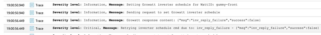

A little to my surprise, it worked. Growatt support disabled "Export limit", but it did not work right away. But after pressing "Submit" several times it worked. He admitted, that their server is a little flaky at times. That's properly the reason for the error. My WW 20:00 export ran allright. Thanks again.
