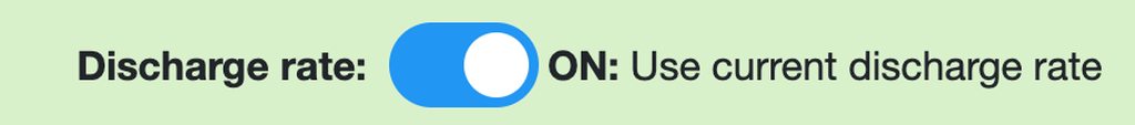

I want to limit the power output of my GE battery when using wonderwatt. I’ve tried to set this up using the GivEnergy app but it still defaults to 100% output.
Is there a way of doing this and still using WW?
First time WW user here.
Ggm We already use the current discharge power for export schedules, depending on whether the user ticks this:
For charges, in the schedules section, we dynamically adjust it as well, or set it to 100%.
For agile schedules, as it only deals with half hour charge slots and cheap pricing is of essence here, we also set to 100% charge rate.
What specific scenario would you want this for? It helps us understand different use cases, thanks!
