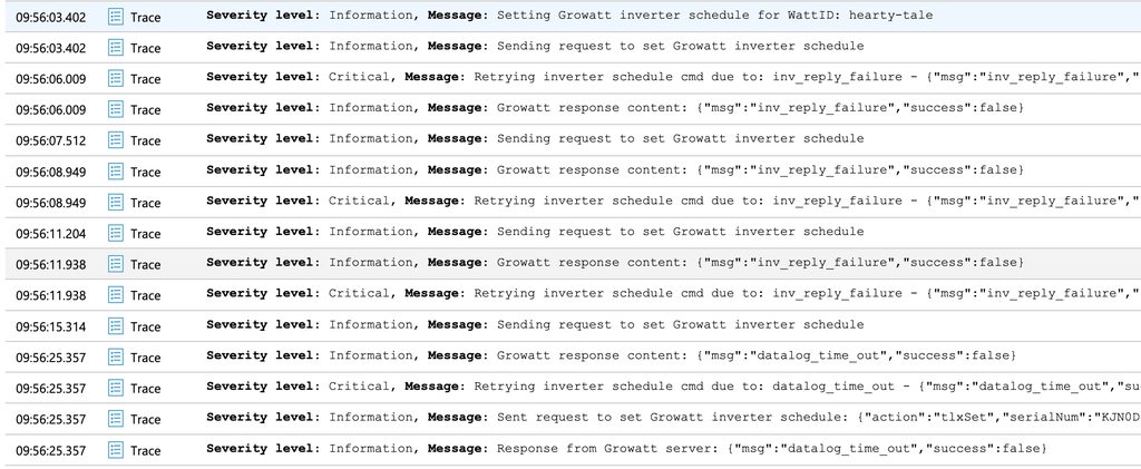

LarsMalm "Failed to set inverter schedule" was information in Activity Log. How can I know the reason for this?
admin LarsMalm I believe your WattID (in Advanced section) is hearty-tale? The detailed log shows an error response from Growatt: Looks like a connection timeout issue with your data logger?
