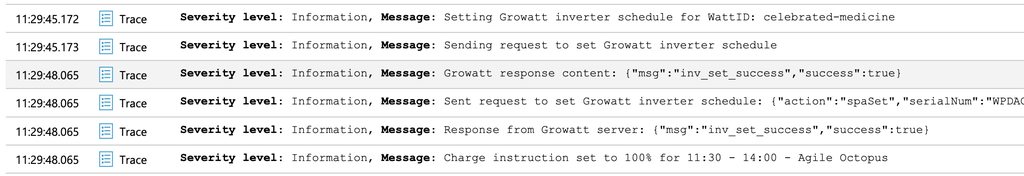

        Looks like this block charged fine today, due to negative pricing.
        Also from our internal diagnostics log:
        Price is 0 or below - ignore current SOC, issue Agile Octopus charge 11:30 - 14:00 for user - celebrated-medicine
