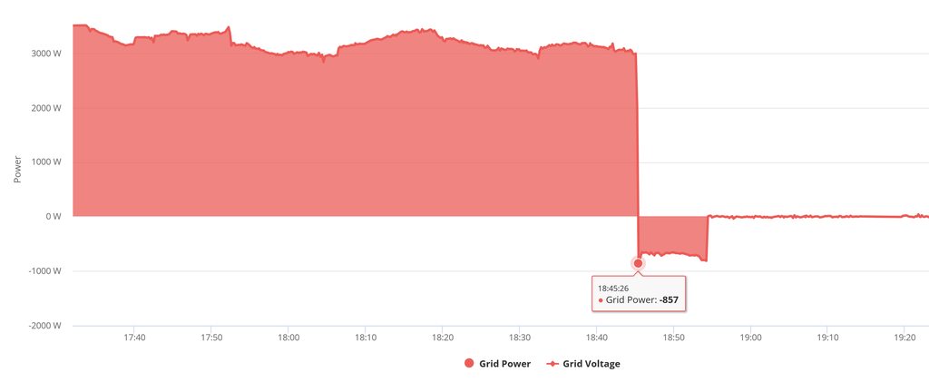

Hi. We're on Octopus Flux, so generally export 4-7pm, but with a minimum battery % set. This evening, the export stopped early because the minimum % was hit prior to 7pm. However, since Eco was set to off unnecessarily, we ended up importing from the grid for 15 minutes! Exactly when we don't want to pull from the grid because it's more expensive then. If Eco had been on, we'd have just pulled from the battery. Having Eco on during an export session does not prevent or interfere with the export.
This image shows us exporting to the grid, until 6:45pm when we get down to the minimum battery %. Then we switch to import. š š
Please can you not turn off Eco during the export session?

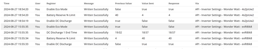

Here's the inverter log for the timeframe:
