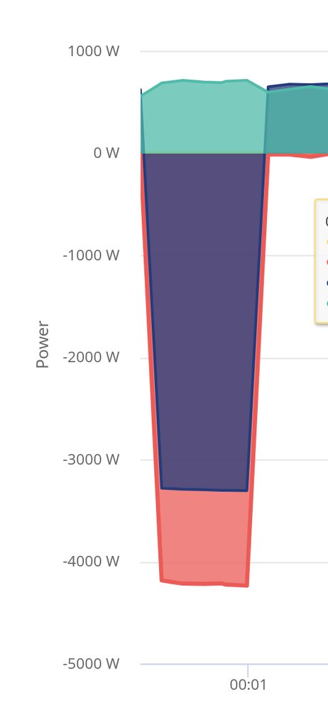

The reason for this is due to my Gen 2 inverter doing a strange one minute charge, starting at 00:00:00 and ending at 00:01:00 as per this screenshot:
For the entirety of the one minute the clock shows 00:00, it charges from the mains!! Erm..
The only way I can prevent this is to ensure 'AC Charge Enable - False' is set.
