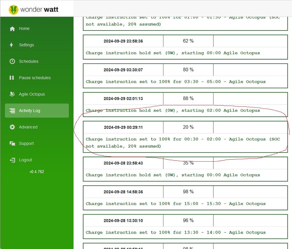

    Perhaps we should log this in your Activity log so you are aware. Or maybe set a default assumed SOC of 20...
      admin Thanks for investigating.
      It failed again last night. I believe this is due to a known issue with parallel AIO systems which also impacts the GivEnergy portal and phone app, data screens. I've asked them to escalate fixing this.
      In terms of mitigating a NULL value, your suggestion seems good - assume a low value of 20 (I don't think it's worth having a value in the advanced settings for this as it shouldn't be happening that often in the first place), and reflect the assumption when writing to the Activity Log (something like "SOC not available, assuming 20%").

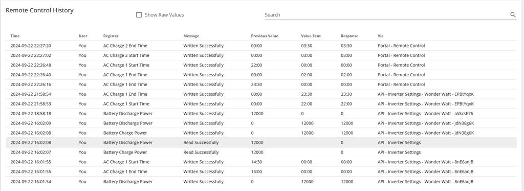

        On another note, do manually scheduled slots appear in the Activity Log?
        The entries below at 21:58 do not appear in the Acitivty Log.
          DualAIO You mean using the Quick Schedule mechanism? Should do yeah.
