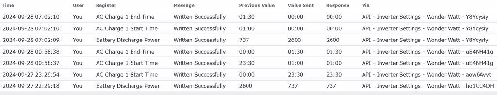

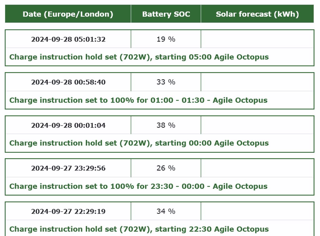

    johalareewi We can see there is currently a new agile charge block for 1:00-5:00 that reflects what you see in th UI.
    However at the time the instruction for 1:00 was sent, this was not there. Instead there was a block for {"Id":272831, "FromTime":"2024-09-28T01:00:00","ToTime":"2024-09-28T01:30:00"}. The new schedule (1:00-5:00) has an Id in the range 273100ish - which means it was written after 1:00 and that specific schedule was not available at that time.

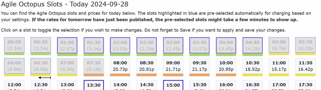

        I same home way after midnight and fired up the Agile Sessions screen to check the overnight slots before going to bed.
        The 01:00-01:30 window was auto selected as was the block 02:00-05:00
        Battery SOC was a bit lower than expected so I manually selected the 01:30-02:00 slot.
        Clicked SAVe and the screen updated to show 01:00-05:00 all selected.
        I went to bed.

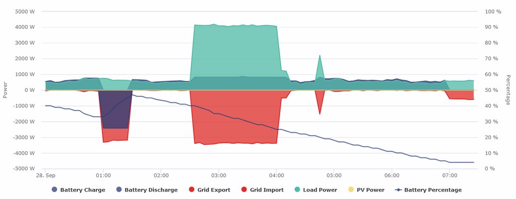

        When I got up in the morning, only the 01:00-01:30 had been actioned.

          Could it have been possible that the 1:00-1:30 charge had already just started? Which would explain why we see that slot charge instruction. It might just have been issued after you saved and the whole thing became a continuous block.
            admin Maybe, but if the 01:00-01:30 slot had just started, it would have been greyed out on the Agile screen?
              Yes 01:00-01:30 was auto selected. I manually selected 01:30-02:00.
              At the start, the 01:00-01:30 slot wasn't greyed out and it had a thick blue box.
              I selected 01:30-02:00 so that too had a thick blue box.
              I clicked save and the screen was redisplayed with 01:00-01:30 and 01:30-02:00 with thick blue boxes and not greyed out (along with the 02:00-05:00 slots).
