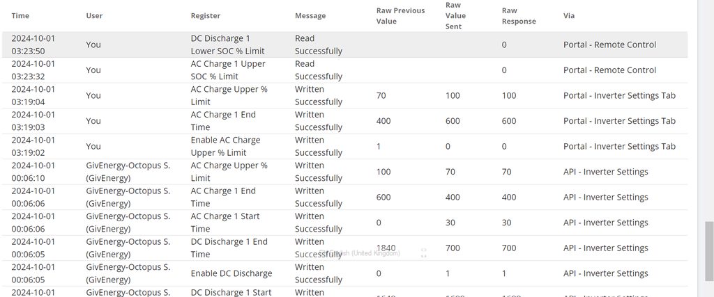

ghoutman for some reason, my night charge 00:00-06;00 was instructed to set to limit at 70% on GiveAC, even though I specified in WonderWatt charging to 100%. Short of manually intervening at 3 am, how can I prevent this from happening and make sure it is set at 100% to begin with? [[URL=https://cdn.brynforum.com/99f6dff024fbe708a5dc1239e2867c39.jpg] IMG]https://cdn.brynforum.com/0297bef76bced9d260e35e38ccdd3381.jpg[/IMG][/URL]
admin ghoutman Looks like you have a GivEnergy/Octopus integration active, as you can tell by the User field. We add ‘Wonder Watt’ to the ‘via’ field, so this wasn’t us.
