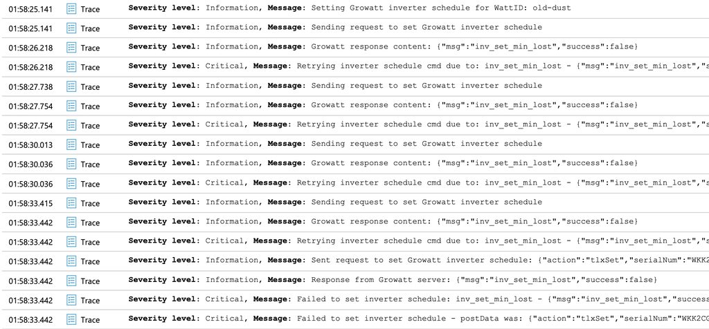

Robbie Looks like we're getting an error response back from Growatt, see below.
Can you confirm serial starts with WKK2?
Basically, you won't be able to set a schedule through the Growatt Shine app or browser desktop either and will get a similar error. So try that, and if it fails, it would be best to get in touch with Growatt.
