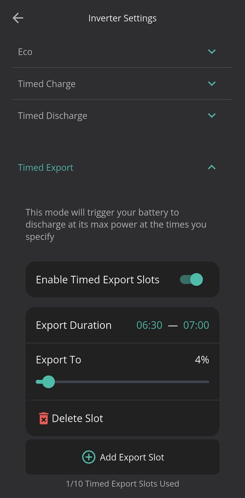

I've noticed that my AIO Timed Export toggle was off, but AFAIK that's always been the case.

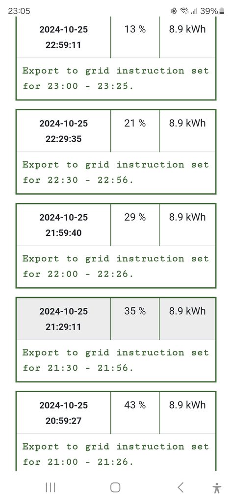

@admin can you please take a look? The instructions are in the log, but the inverter never responded.
Edit: I can see the charge instruction, but it's still not exporting

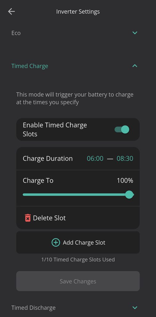

I've noticed that there's a Timed charge from 6-8h30 which it reverts to

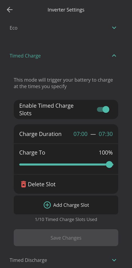

Edit 3:
That's been replaced by a 7-7h30

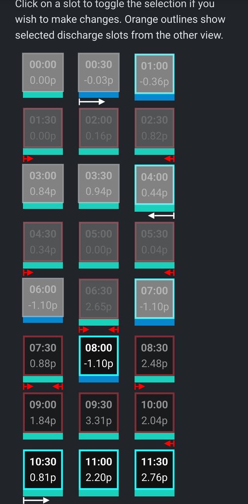

Here are my settings from this morning

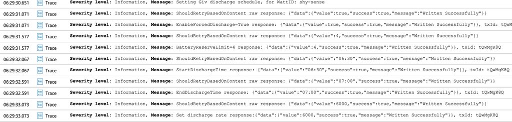

Here's the AIO log.
No discharge at the requested times, but this is the first time I've tried this while the EV was charging and it was set to not discharge to battery, so I've changed that and will see if it works. I'll leave all this here in case anyone else has it.
