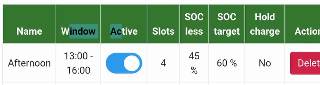

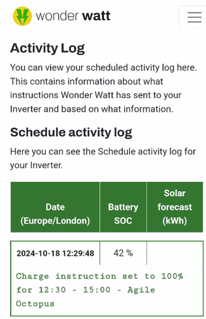

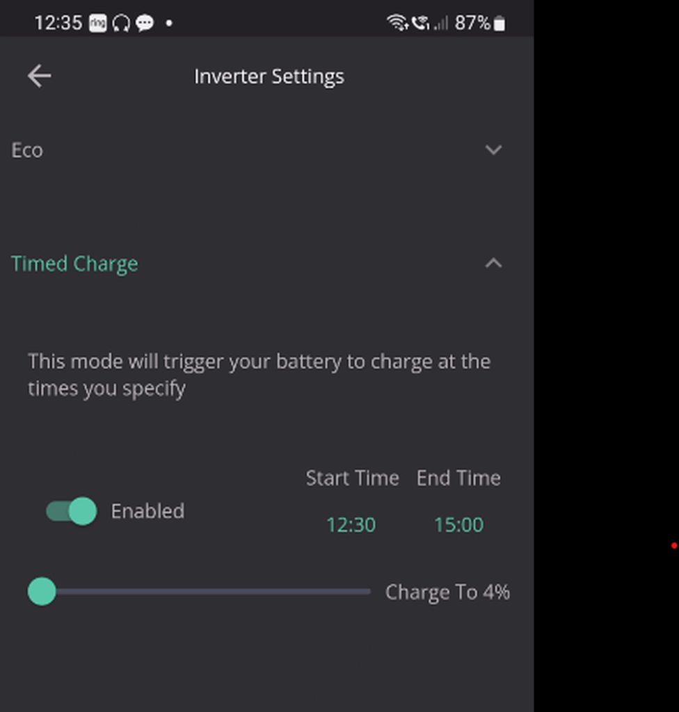

alan I had the following schedule set from 45% to 60% Activity log says charge to 100% The setting on my invertor is charge to 4% If you could look in to this i would be grateful watt id: daring-classroom

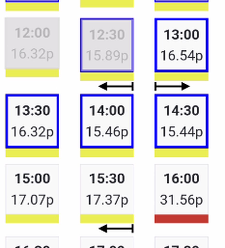

admin alan Your agile charge window is from 13:00-16:00 - but you seem to have selected a 12:30 slot manually and saved. Because the 12:30 - 13:00 slot is outside of an Agile charge window, the conditions and settings for the charge window do not apply.

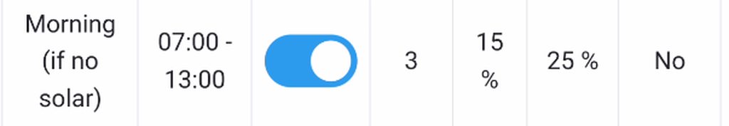

alan Just noticed that the schedule started at 12:30 so was from another schedule This means that the charge was set between 2 schedules so i wonder if this could be part of the problem

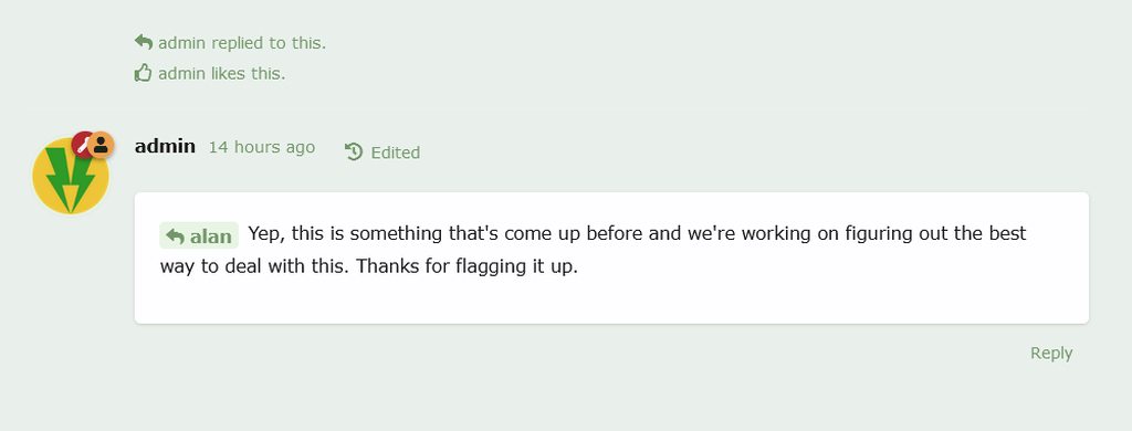

alan I can understand that if the 12:30 slot was outside a schedule it would charge to 100%. What I think is an issue is that when you are moving from one schedule to another (or from no schedule to a schedule) the command should be resent to the inverter as new instructions otherwise if slots are together between schedules the second schedule would always be ignored.
admin alan Yep, this is something that's come up before and we're working on figuring out the best way to deal with this. Thanks for flagging it up.
