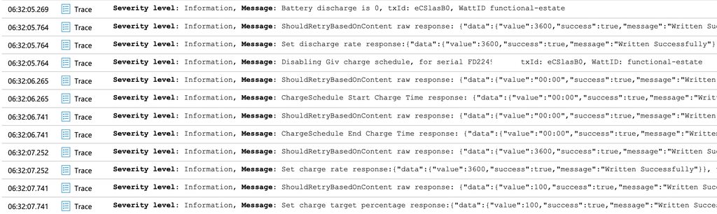

Huey Thanks for digging those out.
2024-10-21 06:32:05 You Battery Discharge Power Written Successfully 0 3600 3600 API - Inverter Settings - Wonder Watt - eCSlasB0
As you say, you can clearly see we write the discharge power back to max - 3600 W.
Now, this line says it's only a Read?
2024-10-21 06:32:10 Server Battery Discharge Power Read Successfully 3600 0 External Change Detected - but unsure how the external change mechanism which Giv has recently introduced is working.
Would be worth sending these logs to Giv (they have access too, but to highlight the specific instance here) and explaining the situation.
