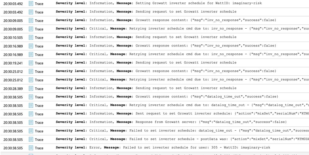

ALLENPATTRICK Looks like an issue with the Growatt API, this entry is specifically for the 20:30 Agile charge slot failure, see our diagnostics for details of the responses from Growatt:

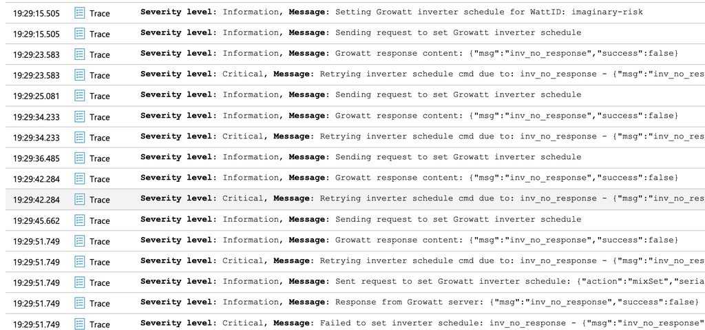

The one yesterday for 19:30 charge to 00:00 diagnostics show the same issue:
Could be a comms/connection issue, but even with retries, this was unsuccessful.
