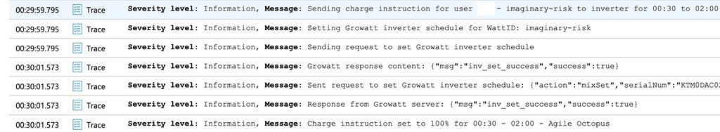

Around 1 am this morning I noticed that charging slots between 0030 and 0200 were not being actioned. My batteries were almost empty following previous days export and I went into panic mode. The activity log was not displaying any error. I made 2 attempts using Quick Charge but they seemed at the time not to be working. Subsequent examination of the battery trace showed that I may have been premature in deleting these before 20 minutes was up. To cut the story short I could not get my battery charged with my WW tools. I paused all and went manual.

The activity logs show no errors and it was quite by accident that I discovered the problem.
My Quick Charge does not appear to work and it could be that I have inadvertently changed something at the Growatt end while getting my charge session to work. I have left the session entry and will ensure that it is deleted before tomorrow.
