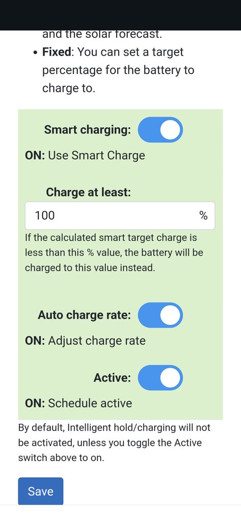

Appreciate this might be a bit of a niche request but, I've got WW set to use auto charge rate for IOG, which works really well for normal 23:30-05:30 charging, putting less strain on the batteries/inverter and accounts nicely for the slow down after 90% and typically my batteries finish charging around 05:15.

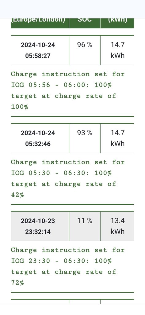

Recently, however, I've noticed Octopus doing weird things with the charging schedule, notably something happens at 05:56 when the schedule gets interrupted/changed and a couple of times this has left me short of 100% in the GE batteries.
This is not at WW fault, as you're picking up the schedule changes.
The problem is, the schedule has been shortened, so the original adaptive rate no longer meets the required SoC requested.
Now, I know I could work around this by asking Octopus for more charge, changing the ready by time, manually switching to 100% rate in we but, if this could be automated it means I don't have to remember.
FYI, I'm using charger integration with IOG, so they have no idea what the EV SoC i and last night the car didn't quite finish charging.
