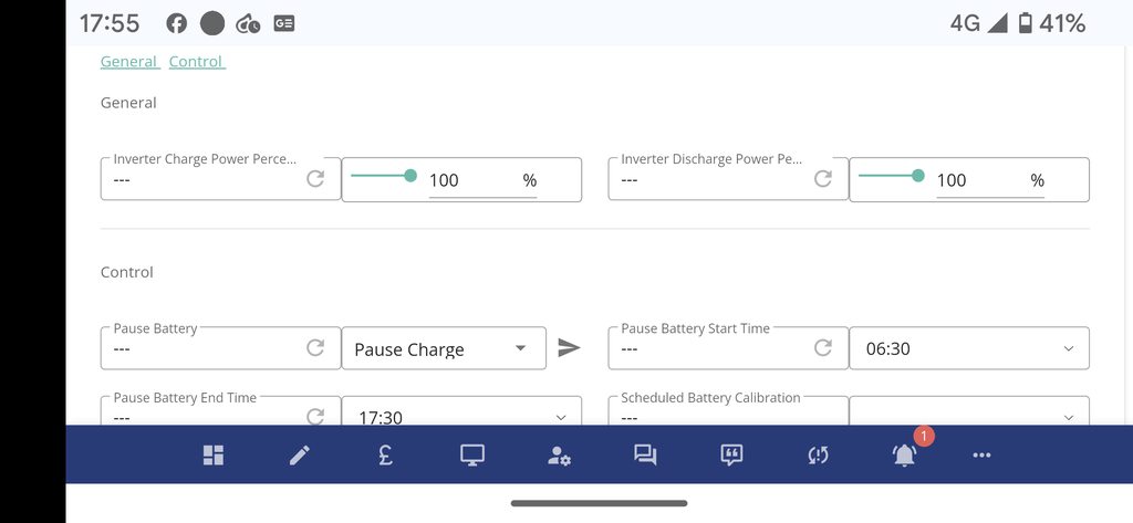

Browni I have recently joined wonerwatt and have an agile import and a fixed export. Unfortunately the discharge is only about 9 watt from the battery even when I use Givenergy app to fully discharge the battery to the grid. Can someone cast an eye over my settings to see if there is a problem. I have contacted Givenergy and all seems fine with them. My ID is unripe-birthday Best Regards Ian

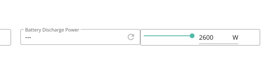

admin Browni First thing to check would be Battery Discharge power in GivEnergy portal - under My Inverter, then right hand menu, Remote Control. Should look something like this: Or whichever your max discharge rate is.
Browni All set as described. Loosing confidence in Agile, considering going back to Intelligent flux as all was ok then but is it all connected to the hour change.
