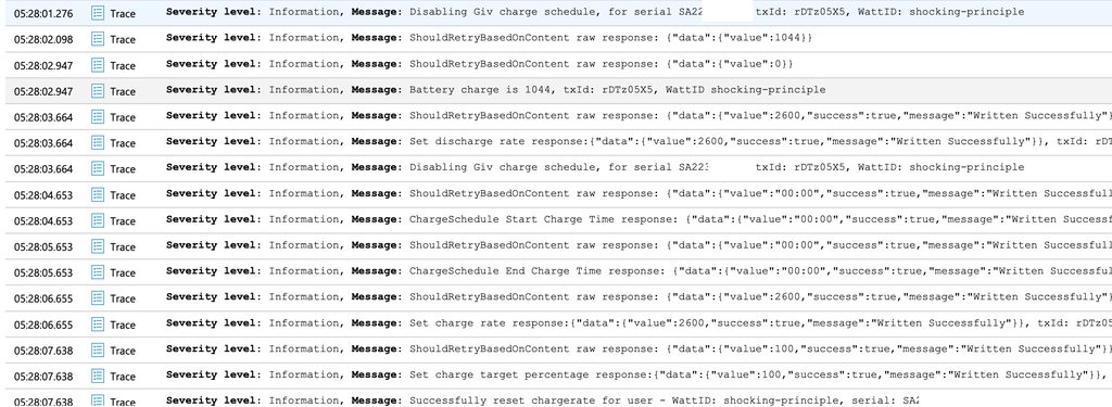

tuckenby Why is this not being seen on the GivEnergy end then?
You should see this. Check at 5:28 this morning - WW txID: rDTz05X5 - should be visible in Giv logs.

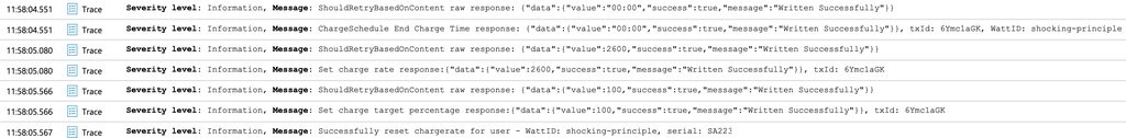

tuckenby Can you see if your diagnostics shows if the discharge value was reset to 2600W after this window ended please?
Indeed it does. Here it is, around 11:58 - as you had an IOG schedule from 8:34-12:00.
And again, you should see this in your Giv logs, tx ID: 6Ymc1aGK
As to why it isn't actioned by your inverter (if this is the case), we can't tell. All we can say is we sent the correct commands to Giv API, and got a success response.
Everything else, is downstream from us.
