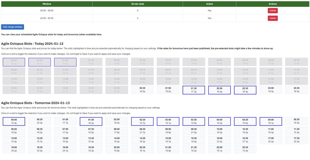

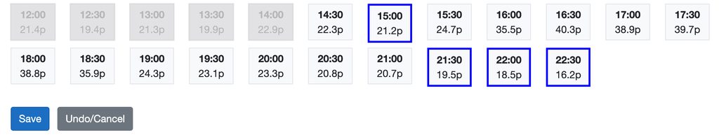

I have scheduled 2 test sessions this evening and so far the first session completed successfully even though there was a inverter timeout error but the session time was set correctly and started and ended as configured
The second session was scheduled for a 10pm start and this is now running .
I have scheduled multiple slots overnight but I feel confident they will run ok if the battery is not fully charged

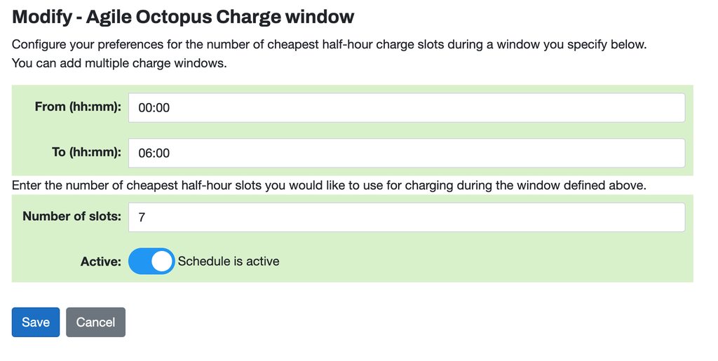

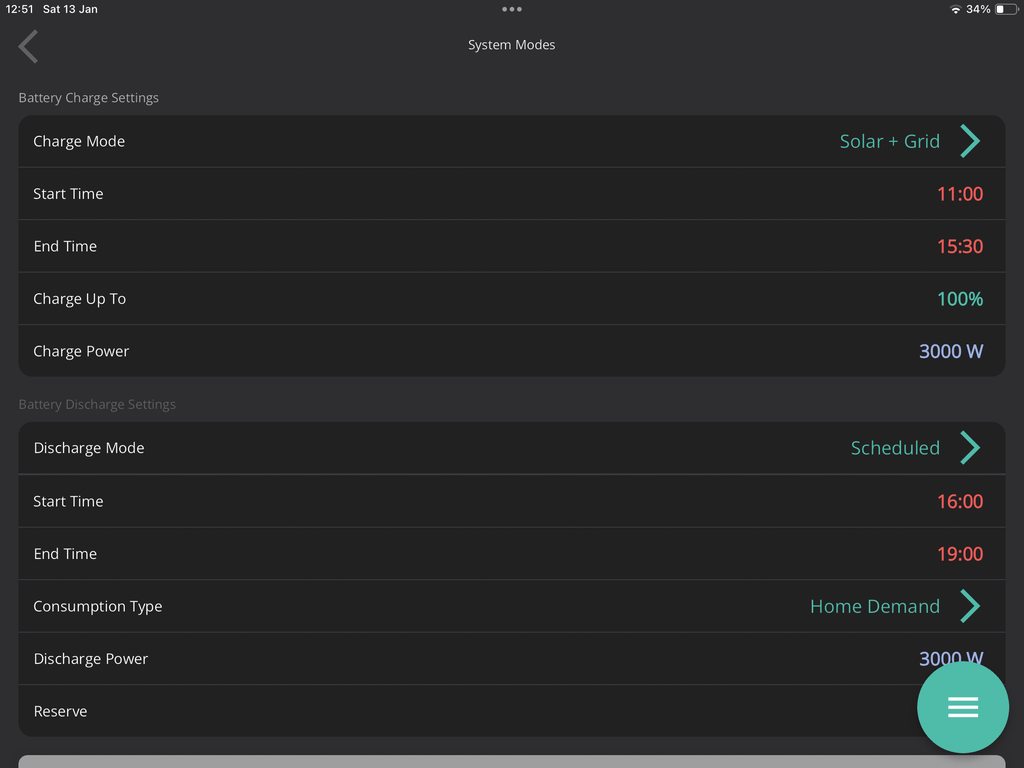

The main question for me is if I have consecutive time slots configured for instance 2am to 6am but the battery is fully charged at 4am ie to 100% is the remaining 2 hours removed, ie the configured charge period removed.

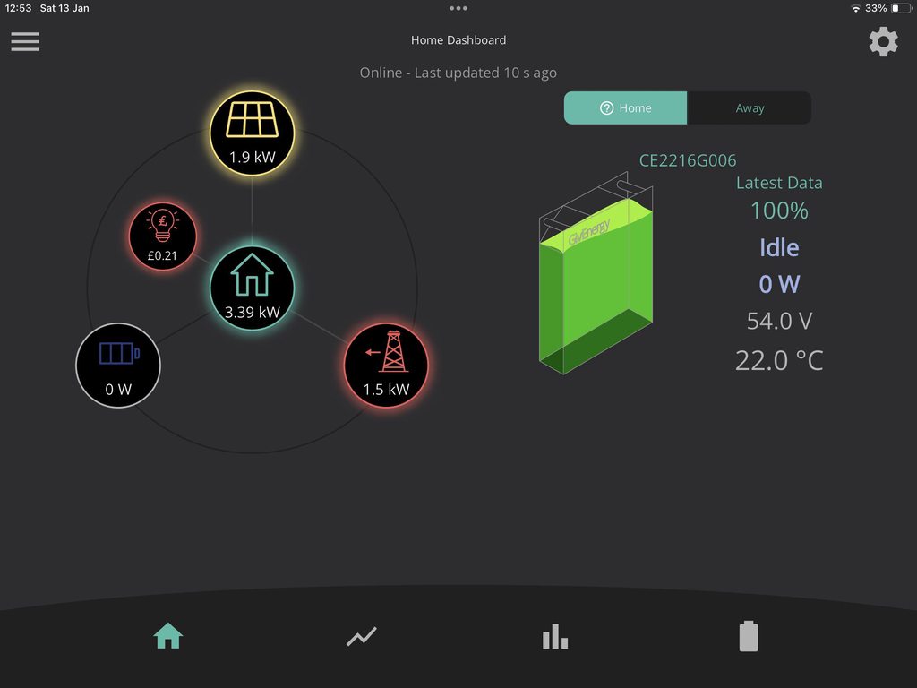

I have noticed recently with the GivEnergy system the battery does not start to discharge and provide power to the home until the configured charge times have expired
I am running a ASHP so this will keep pulling power from the grid until the battery charge period as expired instead of the battery providing the power even though it’s fully charged
