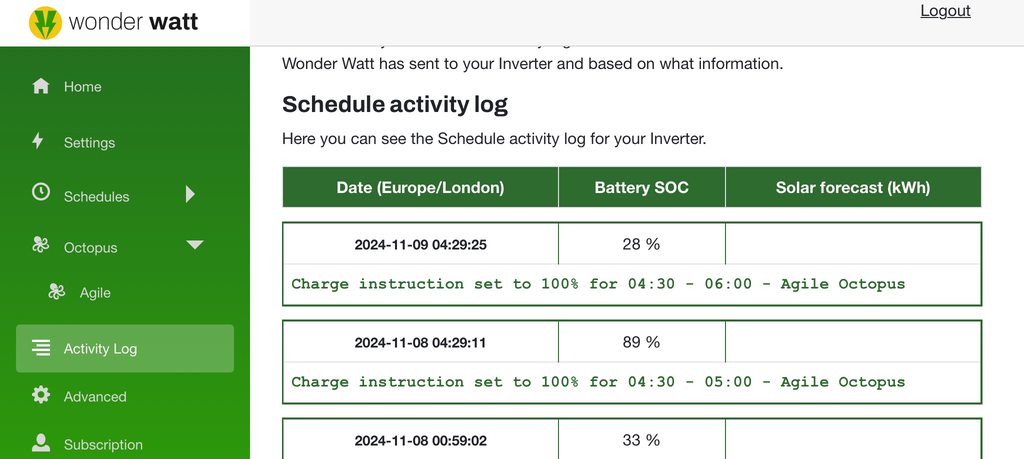

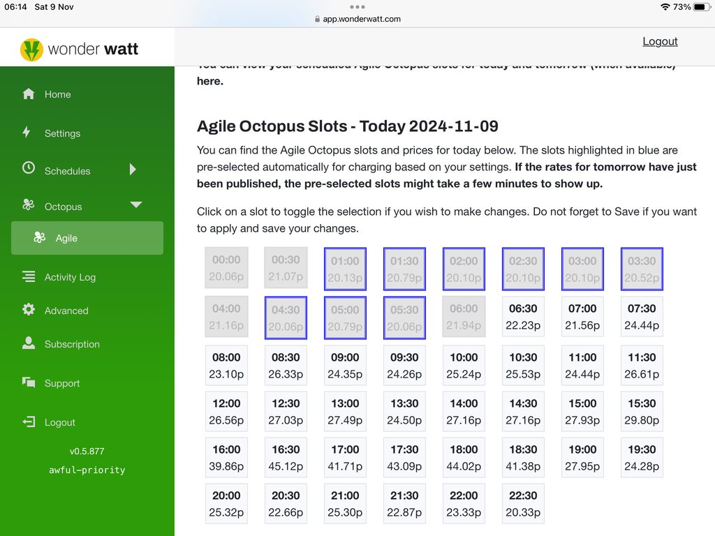

A bunch of slots from 01:00 to 03:30 didn’t action, so battery half charged, no sun for solar top up, and expensive slots for rest of the day :-(
    felmer That's really odd, looks like it was missed, but unsure how - your Agile charge window was active right?
    We'll add more logging to get to the bottom of this.
    UPDATE: We pushed a function update, just prior to 01:00 - which caused this blip. We'll avoid fresh deployments around the 30/00 min on the hour going forward.
