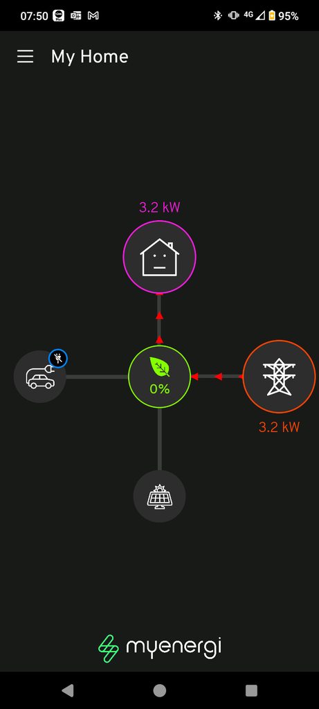

I had a charging slot for battery charge and IO until 07:30 am today. It was still drawing from the grid at 07:50, as.on the attached image, rather than drawing from the battery. This seems to be a common issue for me, as it doesn't stick to the timings that I want, meaning I'm drawing from the grid, rather than the battery. Is there anything that needs changing for it then system to stick to the desired times? Thanks.
    majamo Ah, it looks like your 7:30-8:30 schedule was still Active at that time.
    "ScheduleName":"Charge","TimeFrom":"07:30","TimeTo":"08:30","IsScheduleActive":true
    Deactivating it after it has started has no effect as the instruction has already been sent to the inverter.
    Ah. I had turned that off last night. But it stopped shortly after 07:50?
      majamo Ah sorry, was looking at 21 Nov, so yesterday. Are you on IOG?
      majamo Ah well, and your EV supports IOG? You get mapped slots from them?
      In which case, we had not enabled IOG for your account, it's currently opt-in upon request.
      This has been enabled now and you can access it via Intelligent under the Octopus submenu. Just needs your Octo account number and Octopus API key.
      Also, probably a good idea once enabled to deactivate your other custom charge Schedules as they will be conflicting otherwise.
