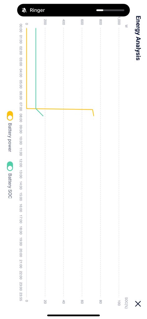

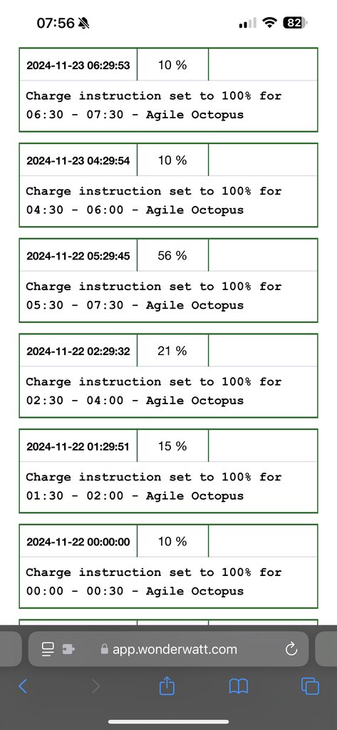

MDB2020 I checked the schedule before going to sleep and I had highlighted blue charging sessions. Am I doing something wrong? It worked last night.
MDB2020 Activity shows that the command went but the SOC shows no change on the Solax app until I instigated a manual charge. WW is suggesting that the SOC did increase via the activity monitor but I can’t see any change! !

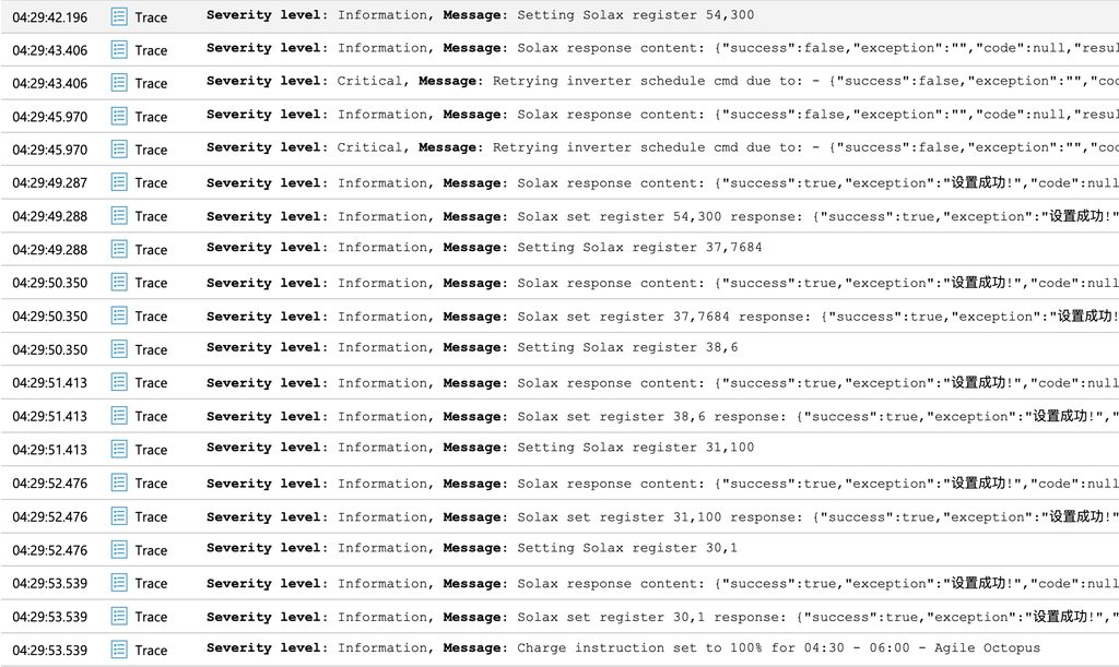

admin MDB2020 Found your WattID, glossy-perception - our logs show (for instance around 4:30), that all registers were set and we received no error back from Solax, see below. Can you confirm your Solax firmware is up to date?
