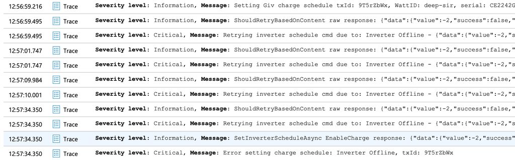

Can anyone interpret these error codes please:
Error setting charge schedule: Inverter Offline [9T5rZbWx]
I know my internet connection was up and functioning as I have Ring camera logs for the period.
There doesn't seem to be any other problems as i was able to manually set the battery to charge an hour and a half late via the Givenergy portal.
    Gimlet That's the direct error message we got back from Giv. See our detailed logs.
    Strange.
    As stated the gigabyte fibre internet was connected as I have video from the Ring video cameras for the same period, and the inverter is only 3 metres away from the router.
    Plus the GivEnergy battery inverter was connected and hour and a half later when I noticed the problem and used the app to start the charge period.
    I'll be watching closely in half an hour's time to see that it works for the 22:00 to 24:00 charge slot.
    Great to see it successfully set that charge schedule, just hope it does the 04:00 to 07:00 ok as I'll be asleep then!
