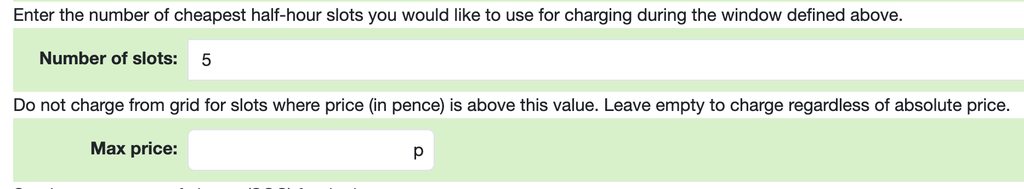

I note you have a very useful setting to always charge when a slot is below a certain amount.
It would also be good to have a setting to never charge when a slot is above a certain amount. So pick the 10 highest slots but don’t bother if the rate is above 22p. The reason I ask this is I’m trying to balance solar in the afternoon with the amount of energy I need for the peak period and this amount climes can vary according to what the prices are. So if I have to charge at say 25p all afternoon then I would rather not bother charging and just see the peak period through with a lower charge.
The problem I’m trying to get around is an afternoon like this one where there are some slots above 25p and yet later in the evening there are some cheaper slots. I would rather ignore these 25p slots and then see out the peak period with a lower battery.

    So regardless of cheapest say 5 number of slots in an Agile charge window, if they're all above 22p, don't select them for charging. Or perhaps only select 2 if 2 of them are under 22p.

        admin Is the test done when auto selecting slots or when the charge instruction is sent to the inverter? Basically, can I manually select slots that are over the max price and have them charge the battery?
          johalareewi The check is done as part of the auto-selection process at 16:35 or whenever you Save changes to your Agile charge window - including setting it to active.
          So you can indeed manually select slots that are higher, just be aware of the repopulation. So best to manually select up to 16:00.
